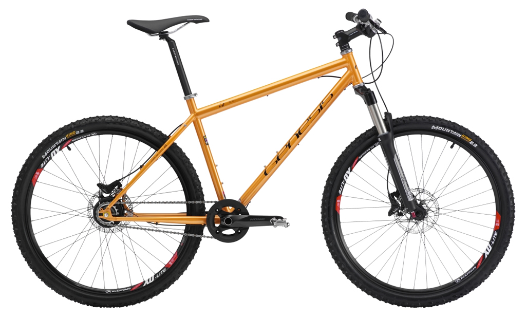

The internal drive iO ID has the gear range needed for all-conditions riding, however the silence at speed from the constant chain tension brings a quiet calm to riotous trails. You may be seen before you are heard.
This bike could only be conceived in UK riding conditions. With a wide ratio 8-speed Alfine disc hub for problem free shifting in filthy conditions, the iO ID is a limited run, steel-framed mountain bike that could be a precursor to the future of drive-trains. Using the same geometry as the Core and Altitude bikes, there are moments on any ride where the ground clearance and static-shifting ability of this transmission allow you to clear terrain which causes others to stall.
Denne er testet i februar nr av MBR sammen med en Orange Five S under tittelen "Mud pluggers". Det er ingen tvil om at testerene er meget begestret for denne og Alfine i særdeleshet. Mye av teksten handler nettopp om Alfines egenskaper. De skriver bla dette under konklusjonen:"...the Alfine hub gears´performance is a revelation" Og videre: "The actual gear shifting performance on the IO ID is awesome." Må si jeg har trua på at det kommer til å skje mye innenfor drivverk/gir konsepter de kommende årene. Og det er jo egentlig på høy tid
