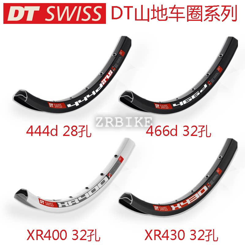

DT 533d ser ut til å vera lik type felg, men breiere. "I'm very impressed with a DT Swiss 533D rim I built up on a ProII hub recently. Good width, built and tried very easily, and went up tubeless with no issues at all." http://singletrackworld.com/forum/topic/new-rim-advice-1#post-7922210
Re: Kan man sette opp alle felger slangeløst med teip? [Re: elviz] #2435787 05/09/2017 20:50
Registrert: Jul 2004
Innlegg: 9,737
-Jan Offline
Innlegg: 9,737
Og mens eg googla så dukka disse opp. Antakeleg kopivarer:
