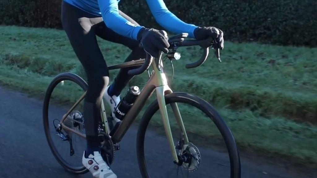

Etter massiv kritikk mot Cannondales nylanserte Synapse med obligatorisk SmartSense med radar, lykter og synlig batteri, svarer selskapet i Cycling Weekly.
Cycling Weekly: Cannondale reacts to negative comments directed at new Synapse with smart technology
Det er dog lite forståelse å spore hos Cannondale for innsigelsene mot systemet og pakkeløsningen.
Om verdien av SmartSense:
Sitat: Clive Gosling, Cannondale
SmartSense is new and different so there’s always going to be a mix of reactions. (...) Cycling can be intimidating and we’re helping to alleviate that through the confidence and convenience of Synapse with SmartSense. (...) We’re very pleased with the Lezyne lights that can come on automatically when the rider walks up to the bike, adjust themselves in low light, alert approaching drivers and the ride for added safety and work seamlessly with radar for additional awareness. All this without having to charge and remove on average four items off the bike but just a single battery.
Om plassering av vesker:
The lights are attached via GoPro-style mounts, so easy to relocate with GoPro extender arms. See the pic attached [above] of one with a pretty big bikepacking bag, but with three sets of bottle cages and top tube mounts. I think a top tube bag is a better solution for UK riders. These extenders could also relocate the front light for use of a bar bag. There are also saddle bag options that fit the current set up. It’s all about finding what works for you.
Cannodales definisjon av bikepacking synes å skille seg en smule fra den mer utbredte ICON_SMILE
Om plassering av batteri:
If it was internal you would struggle to remove it in two seconds for charging which is a key contributor to the convenience of SmartSense. Ease of use trumps hiding the battery and with bottles on the bike the battery is virtually hidden.
Om tilgang på sykkelen uten SmartSense:
We offer the Synapse Carbon 4 model SmartSense ready, without the hardware. Of course we would love riders to experience Synapse with SmartSense and see how the new features can make their ride more enjoyable.
...og flere andre spørsmål og svar om utforming og plassering av lykter, virketid for batteri, kompatibilitet med andre merker osv.
Jeg ser som nevnt flere fordeler med det nye rammesettet, og har vondt for å fordømme et system som fremmer sikkerhet og kan redde liv.
Men jeg savner valgfriheten.
Håper at Cannondale lytter til kritikken og gjør det mulig å velge sykkelen med eller uten det elektroniske systemet. Og ikke bare med én modell. Som attpåtil ikke tilbys i Europa.

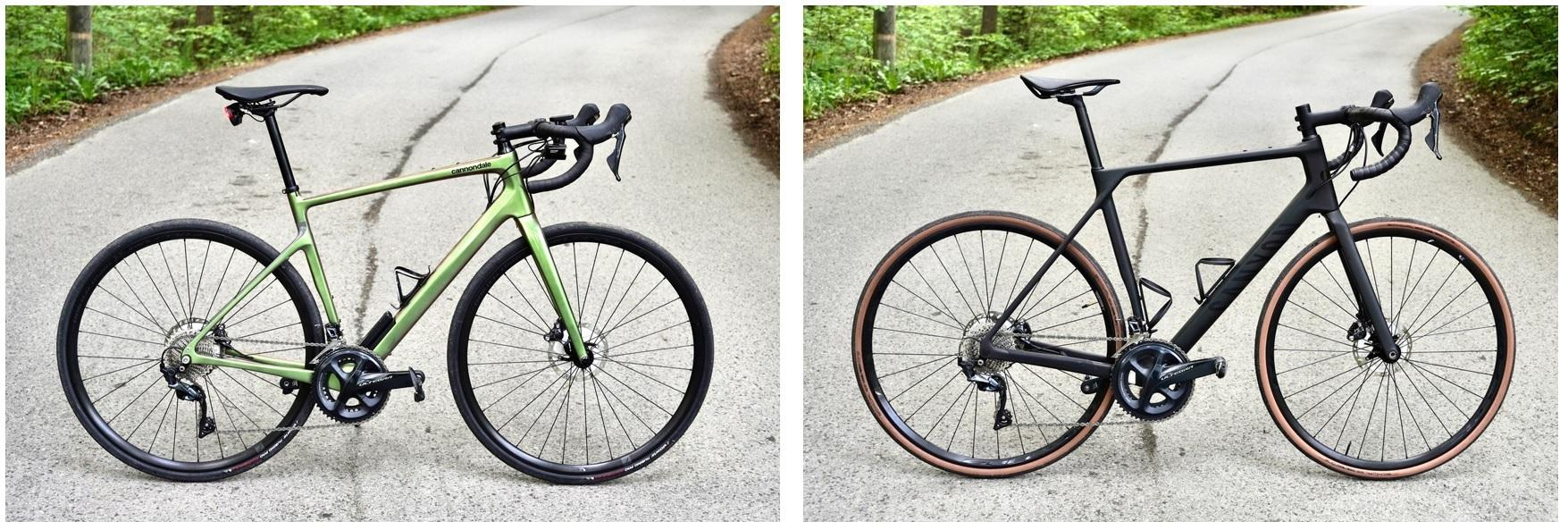

Tråden har mistet noe av sin gnist siden selv de råeste rittsykler er blitt allsidige etter standarden som hersket da tråden ble opprettet. Og godt er det!
Men:
Fra tid til en annen dukker det fortsatt opp noe annerledes, modigere, uvant, som skiller seg fra mengden og samtidig knytter sammen fortid og nåtid.
Juni 2015: New Road. Clean Slate.
Mai 2022: Introducing the RATT- go anywhere fast
Rondo: RATT

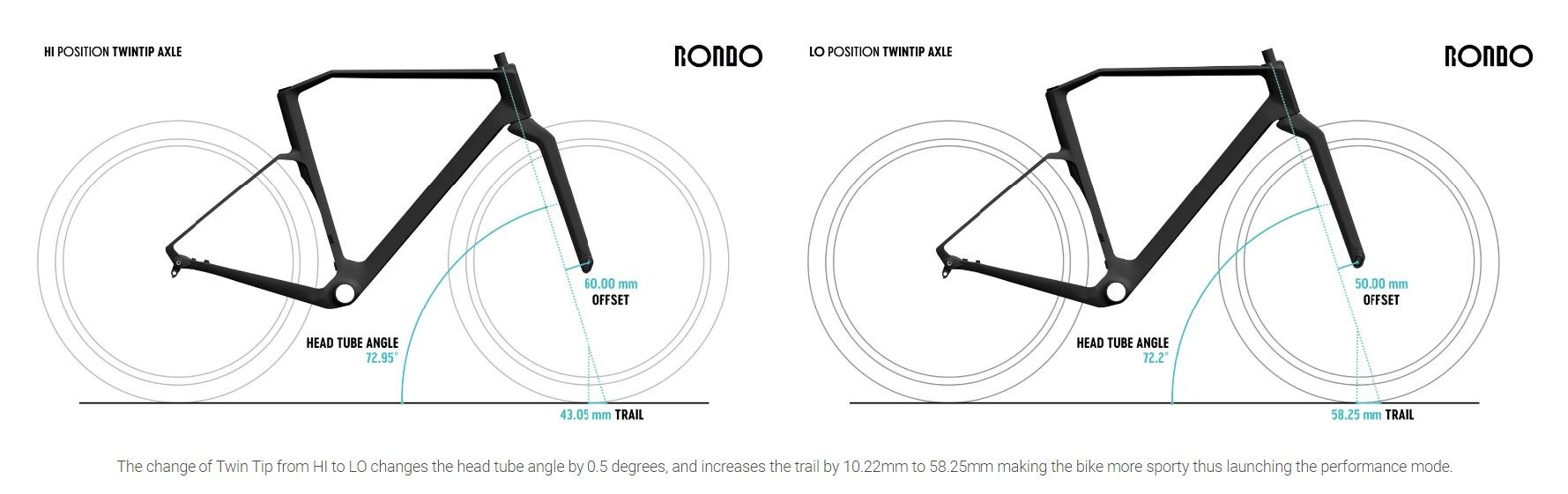

Jeg kan røpe at det ikke er helt uvanlig at første kommentar om RATT gjelder utseendet.
Jeg er tilbøyelig til å regne den slående gaffelen som et artig visuelt uttrykk for et geometrisk hovedtrekk ved sykkelen - om ikke annet et nikk til dem som forstår hva som er særegenheten ved gaffelen og dermed RATT:
Gaffelen har usedvanlig langt fremløp/fork offset - tenk gaffelbøy - helt opp til 60 mm. Formålet er å redusere slep/trail og oppnå Low Trail.
Low Trail kjenner vi fra blant annet klassiske touring-sykler med karakteristisk gaffelbøy. Rondo gjør en vri på det klassiske designet og snur gaffelbøyen opp-ned. Szymon Kobylinski og hans lystige venner har hatt det moro her.
Poenget er at forlenget fremløp gir usedvanlig kort slep/trail hos RATT, helt ned til ekstremt beskjedne 43 mm (!) Tanken er å gi responsiv styring som en rittsykkel til tross den innebygde tregheten i 650b 47 mm dekkene, med sin brede kontaktflate, som sykkelen er designet rundt.
Kombinert med rimelig krapp styrerørsvinkel opp til 72,9 grader, korte kjedestag på 415 mm og Rondos karakteristiske twin-tip, der du nettopp velger mellom 50 og 60 mm fremløp for mer eller mindre aggressive kjøreegenskaper, får du en sykkel med landeveisegenskaper for all slags underlag.
Som Rondo skriver: “Low Trail” – a question of offset: Same speed, wider tires.
Og gaffelen skriker nettopp det.
Og så kan man åpenbart velge 700c der 28 mm vil tilsvare brede 650b 47 mm. Men dersom man med 700c stiller chipen i gaffelen i HI for 60 mm fremløp og dermed kun 43 mm slep/trail, kan jeg ikke tro annet enn at man får en ekstremt lettstyrt sykkel som mange vil oppleve som nervøs. Med LO og 50 mm fremløp dermot, vil slep være mer alminnelige 58 mm, som man gjenfinner på mange landeveis-rittsykler. Bredere 700c-dekk, helt opp til 38 mm, vil gi lengre slep og roligere kjøreegenskaper.
Hva gjelder vinkelen i overrøret, åpner den for kortere seterør og lengre setepinne for vibrasjonsdemping og økt komfort. Vinkelen i seterøret er likeledes tiltenkt for vibrasjonsdemping.
RATT plassereres seg i det deilige All Road-rommet mellom Gravel-sykkelen RUUT og Road Plus-sykkelen HVRT. Sistenevnte ble som kjent kåret til årets sykkel av Bikeradar i 2019 ICON_SMILE
Så ja, jeg synes designet er spenstig og reflekterer tanken bak sykkelen. Så er det bare for andre å skrike seg hes om at det er stygt siden det er annerledes ICON_SMILE

Sitat: sun flyer
Jeg får vondt i øynene av å se på den.. Auu!
Ikke når du sitter på den ICON_SMILE

De traff i hvert fall nesten på navnet
Re: Beste allsidige landeveissykler? [Re: neonstz] #2708906 27/05/2022 07:33
Sitat: neonstz
Sitat: Sepeda
Rondo: RATT CF
Førsteinntrykket mitt er at Rondo hadde et overskudd av vinkler de måtte bruke opp.
Mitt førsteinntrykk var at den burde hatt elevated chainstays. ICON_WINK
Takk til Sepeda for både å bringe den fram i lyset og gi en opplysende forklaring med egne ord på utseendet. Det settes pris på.

Mildt sagt polariserende design, men jeg liker at de er annerledes. Det meste er jo relativt likt designmessig om dagen.

Men jeg lurer rett og slett på om dette med endring av geometri har så mye for seg at det verdt den ekstra kompleksiteten. Det er flere sykler som klarer å fungere bra som både racer og gravel-sykkel uten en sånn løsning. Jeg følte ikke det tilførte Rondo Ruut så veldig mye annet enn potensiell skrangling og løse deler. Men det virker som om det er bedre løst her - du skal i hvert fall ikke trenge en ekstra bremseadapter f.eks.
ICON_SMILE
Ser absolutt poenget.
Samtidig har jeg likt tenkingen bak Rondos Variable Geometry helt siden jeg fikk studere RUUT på tegnebrettet og diskutere prinsippet med en av daværende NS Bikes' designere som i en periode bodde i Oslo. En og samme sykkel med variable kjøreegenskaper fra rittsykkel til komfortracer eller landevei til grus - bring it on! Opplevde idéen som uttrykk for genuin sykkelinteresse og geometriforståelse, og slett ingen billig markedsføringsgimmick.
Og med RATT bruker de samme prinsipp for å gjøre brede dekk mer lettstyrte. Den tanken liker jeg også.
Vi finner som kjent lignende løsninger med omvendbar flip chip i gaffelen også hos andre - som hos siste GT Grade for å kompensere for bagasje på gaffelen, eller Cervélo Aspero for å oppnå lignende kjøreegenskaper med 650b som 700c. I det siste tilfellet har vi noe til felles med RATT.
Men som du sier - den tekniske løsningen må fungere. Og jeg har også inntrykk av at Rondo perfeksjonerer denne. Håper at skrangling er et tilbakelagt stadium.
Tviler heller ikke på at de fleste velger én posisjon og holder seg mest til den, uten at jeg anser det som en svakhet ved designet. På RATT og Áspero ville i hvert fall jeg ha variert alt etter hjulstørrelse.
Men du har jo faktisk erfaring med noen av disse syklene, både RUUT og siste GT Grade, i motsetning til meg ICON_SMILE
Uansett:
Noe av det jeg synes er kult med RATT, og som er betegnende for rockerne i Rondo, er at:
- De vet at designet på gaffelen vil utløse forutsigbare rop om hvor stygt det er. Likevel kjører de på.
- De vet at chip i gaffelen vil utløse forutsigbare rop om at der er en gimmick. Likevel kjører de på.
- De vet at 650b og Road Plus i praksis er avskrevet for rask landeveissykling, ikke lenger er trendy på grus, og vil utløse forutsigbare rop om hvor lite areodynamisk det er. Likevel kjører de på.
Og de kjører på fordi at de har tro på at RATT blir en sabla gøyal, rask og kjapp doning på alle slags veier, i den virkelige verden, til tross for alt som umiddelbart taler mot den og alle ropene om hvor fælt alt ved den er.
Det synes jeg er topp. Og syklistene som blåser i det konvensjonelle og anskaffer en RATT, kommer til å være de kuleste guttene og jentene i gata. Barnslig, men gøy.
For en mer sober bedømmelse, er sykkelen nå testet av Rennrad News. Om man har glemt skoletysken, er det bare å be Chrome oversette.
Må si at jeg ikke er prinsipielt enig i alt som skrives der, men det er jeg sjelden ICON_SMILE
Rennrad News: Gravel express with race geometry

Nå er forresten en fersk test av nye Cannondale Synapse og Canyon Endurace CF oppe på siden:
https://www.landevei.no/sykler/landeveissykler/test-av-cannondale-synapse-carbon-2-rl-2022
Hadde vert knall om en kunne få tak i løse Synapse rammer av den nye typen uten detta lys\batteri opplegget.
Felgbrems <3

Takk, Øyvind! Tipp topp med test av disse klassikerne i siste versjon! De var naturligvis blant syklene som ble nevnt på første side av denne tråden i 2017 ICON_SMILE
Jeg skal ikke røpe konklusjonene - man kan få tilgang til testene for så lite som kr. 99! - men synes det er kjekt at Canyon tar i bruk rimeligere karbon CF for å gjøre denne favoritten enda mer tilgjengelig. Tidligere har skive-versjonene kommet i mer kostbare CF SL og SLX, mens den nå utgåtte karbonversjonen med felgbremser kom i CF.
Legger merke til at du for begge sykler fremhever den noe tyngre styringen. Samtidig er begge syklene på papiret og i henhold til andre tester blant de lettstyrte i sin kategori. Og du tar da også alle forbehold om at denne forskjellen oppleves tydeligst om man hopper rett fra en skarpskodd rittracer til en av disse mer stabile syklene, og at man raskt tilpasser seg. Jeg hadde noe av den samme opplevelsen i overgangen fra TCR til Roadmachine, og før det mellom TCX og Grade, selv om jeg må innrømme at jeg samtidig satte pris på følelsen av å flyte på skinner både over ujevnheter og i svinger. Det er noe av bakgrunnen for at jeg liker den nerdete idéen om justerbar geometri, som på omdiskuterte RATT.
Men det jeg egentlig ville si, er: Jeg blir litt nysgjerrig om du hoppet rett fra din Supersix eller endog Exploro, eller om det er en annen skarpskodd racer du driver på og tester ICON_SMILE
Sitat: OleF
+1
Eller om Cannondale i hvert fall tilbød Synapse Carbon 4 uten SmartSense i Europa, slik man gjør i USA!
Så kunne man ha skiftet komponenter etter egne preferanser uten å sitte tilbake med noe du ikke kan selge på Finn ICON_SMILE
Jeg gikk rett fra testing av BMC TeamMachine og Factor Ostro VAM til testing av disse, men var innom egen 3T også - men den har nå 40 mm Zipp-dekk. Men er vesentlig lettere i styringen med så store dekk enn Synapse og Endurace er med 30mm.
