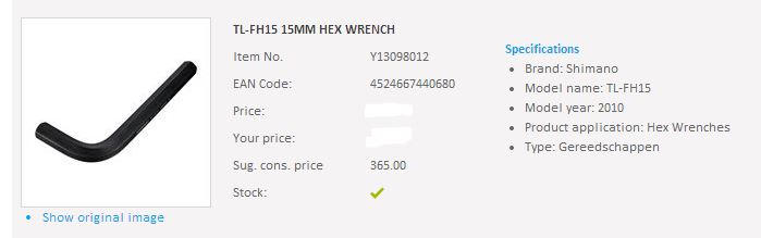

Re: 15 mm unbrako anyone? [Re: Kjartandaddy] #1683021 16/09/2013 14:54
Innlegg: 1,251
Plankepetter Offline
Innlegg: 1,251
Re: 15 mm unbrako anyone? [Re: Kjartandaddy] #1683026 16/09/2013 14:59
